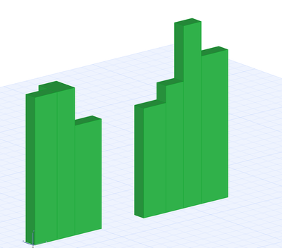

I'm working on a wall panel placer tool that puts wall panels into a wall.
I'm wondering whether (for calculations) is it possible to explode or extract these wall panels into standalone (GDL or not GDL) objects. The goal is to have an ifc export one by one.

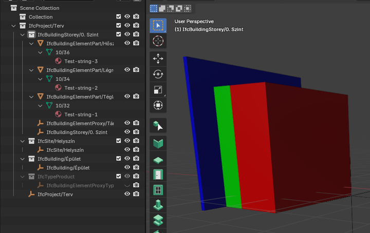

The Building material trick works the same way (if we assign every panel a different building material, they become ifcBuildingElementParts), but I am still not able to assign any info to those parts in GDL (a dynamically generated name would be enough).
GDL/Python/C++ dev
I can define a surface having a chosen name in GDL and then assign it to an object, and by assigning different building materials to every panel, I can make them different IfcBuildingElementParts. This way, I can deliver (only one piece of) info that can be dynamically set.
Unfortunately, it seems that I cannot set/map anything more using the ifc translators, as their Component/Material settings work only for per-building material set properties (I mean, I can use "surface", but not the actual surface of the panel, but the preset surface of its building material).
