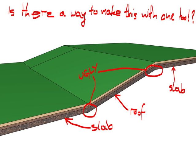

Is there a tool / object for making a mesh with a specified thickness?
gedzior84
Hello.
As in the topic, I wanted to ask you guys if there exists any tool that would allow me to create a mesh with a specified thickness, or layers?
For example, I have a terrain to model, but the ground has layers: 3cm of grass, 10cm of ground and some other layers. The terrain is not flat - it has some holes and bumps. Is it possible to create this with one tool/object, not using layered slabs, roofs and shell?
