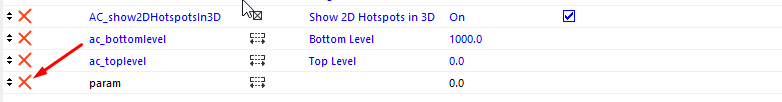

As for hidden parameters, they usually fall into one of the following three cases:
Case 1:
Select the "red X" icon in the parameter list.
Case 2:
There is a command "hideparameter all", which hides all parameters within the Object.
Case 3:
There is a command "hideparameter "parameterName"", which hides a specific parameter.
Please check which case applies to your Object, and simply remove the corresponding setting.
