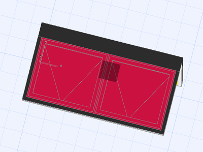

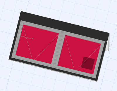

thanks for Your answers, I think the bug shouldn't come out for short scripts (it's too eye-popping), so I have put here the whole gsm (standalone), AC27 .gsm.
The difference is something like this:
and if You comment out 3D script line 280:
    _ = _mat          ! Dummy op
(the frame is 'grey' instead of the given colour.
GDL/Python/C++ dev
