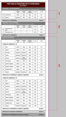

Hello everyone,
Being that I am still new at ways of GDL, I could use assistance.
I am trying to create simple cells that can be moved with hotspots. I understand the basic concept of how to make them move, but the question is how to make them move when they are multiplied. To be precise how to move them individually with different values.
For now, I made  Value 1 and 2 move, but the Value 3 is for me brain teaser.

1 ACCEPTED SOLUTION
Solution
Peter Baksa
You can use ADD2 between different hotspots to make their base and value clearer. The reference hotspot should be in the other direction from base than moving.
GDL objects don't know about other GDL objects, scheduling is not possible.

Hello,
Thank you Peter for the explanation.
In the meantime, I restructured the code so I could learn to use subroutines
I managed to accomplish most of the things that imagined, but I have difficulty to figure how to move a certain hotspot, so it deducts from the B value.
Picture of explanation what I am struggling with

Peter Baksa
It looks like it should change the overall length of the box too?
Then you have to synchronize B with the edited length in the parameter script using GLOB_MODPAR_NAME. When the user edits one of them, the other has to be re-calculated.

Thank you for the replay.
Yes overall length of the box would change.
Regarding your answer I must admit it is a bit abstract for me in the sense that I don't really know how to implement it technically at this point, being that I started on my GDL journey two weeks ago and that I don't have prior coding experience.
Could you give some concrete code structure that I could try, so that I could learn from the example?

With GDL users can change only one parameter at a time (except transferring settings and setting array parameters, but that is a more advanced topic), after each change the scripts will be executed. When any parameter's change (either from UI or hotspot) should affect other parameters' values, these changes have to be calculated in the parameter script. Your script can decide what calculations need to be done based on GLOB_MODPAR_NAME global variable, which is filled with the last changed parameter's name (case-sensitive).
The linked article has an example under "Displaying custom parameters in tracker".
