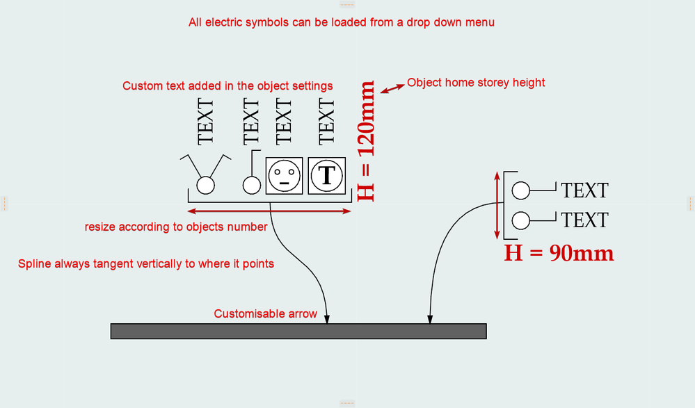

With 0 knowledge , i'm planning to start my first gdl object, a 2D switches for fast electricity plans.
Anyone wants to share thoughts, ideas, advices, it's all welcome, i will share the object, and anyone can work on it, open for all,
My main idea is to have in the interface an add buttom to add items , from 1 to N, : symbols number
Fragments to show and hide symbols, ( each symbol and text is a macro maybe ? )
the text field is a custom text inserted in the gdl interface parameters to tell the symbol fuction ( LED, spot, Fridge ...)
any advices to start ?
Thanks !

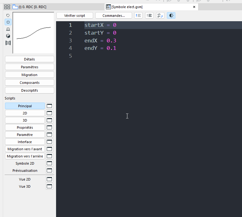

Yves
hotspot2 startX, startY,1
hotspot2 endX, endY,2

Thanks !
how to make hotspots editable in plan ? , i got a static object

Check the GDL documentation on hotspots:
https://gdl.graphisoft.com/reference-guide/graphical-editing-using-hotspots/

First results ! šŸ˜„
Now i need to add text , and control the number of switches,
Any advices,
Below the object files
1 object for for the arrow and the line
1 object for switches used as a macro.
