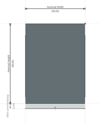

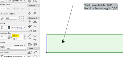

Is there an option or workaround to get the nominal height of a beam (and/or beam segment)?
BEAM_HEIGHT gives you the total height of the beam.

I don't think so 🤔
You can only get the real height (=how the element is modeled and placed), the "nominal" height at this point is merely theoretical.
I also wonder what this info would mean in your context?

I have an 'all purpose' label. It works for every type of element and gives different types of information depending on the type of plans (Architectural, Structural, Energy)  and the usage of the element. Now and then I get a request for extra possibilities.
This time the height of the bottom side of the concrete isn't correct for the structural engineer because they added an extra (stabilizing) layer below the foundation beam (which doesn't has to be measured).

Okay, got it.
You could do a very convoluted workaround by requesting all the profile components, and check their height.
But that does not take into account if you actually changed sizes in the actual modeled element.
The other rather obvious solution is to model those things seperately... 😕
