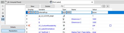

This is not a tutorial but it should help.
First, you need a parameter (a string type) to act as an "id" (as in GDL Ref. Guide for PROPERTY_VALUE_OF_PARENT). Let's call it "criteriaProp".
 *The "gs_ui_current_page" is there for the UI script to work. If you don't have it already, please create it too.

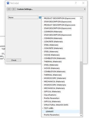

UI script;
ui_dialog "Test Label"
dim pageTitle[1]
pageTitle[1] = "Custom Settings"
dim pageIcon[1]
pageIcon[1] = ""
dim pageID[1]
pageID[1] = 1
ui_current_page gs_ui_current_page
ui_page gs_ui_current_page
! Page 1 --------------------------------------------------------------------------------
ui_page 1, -1, pageTitle[1], pageIcon[1]
dim parentProperties[]
n = request ("Properties_Of_Parent", "", parentProperties)
n = request ("Property_Name", criteriaProp, typeName, groupName, propertyName)
ui_custom_popup_infield	"criteriaProp", 10, 20, 200, 20,
						1, 3, 2, propertyName,
						"None", "", "", "None",
						parentProperties
Here, we populate the requested "parentProperties" into "criteriaProp" so you can select which property to use as a criteria.
The requested "propertyName" is there so the UI show the title instead of "id" after a property is selected. (Within the ui_custom_popup_infield .... , try and replace it with "" and see what happen after selecting the property in UI).
The "None", ... is there in case there is no supported property, just in case...really. You can also set the parameter to "None" as default if you want to.
