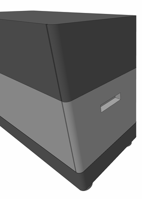

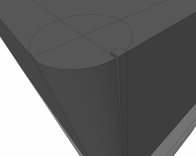

I'm building a parametric component for a modular battery storage unit. Everything works in terms of basic geometry creation, but I want to finish the component with some additional details - recessed handles and grooves.
This is what the 'dumb' component looks like:
This is the parametric one:

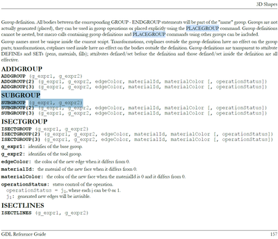

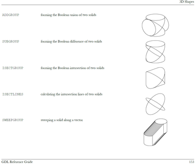

There are actually two types of groups.
  1. Groups you have created with the GROUP command, which you will refer to with a string: "my group" (can have spaces)
  2. Groups that result from a compound command, like SUBGROUP.
The result of the latter will be stored inside a variable – kind of like a function in other languages.
Funfact: VARTYPE will show type 2 for this variable (means string!), but you can not actually do string operations with this. Instead this works like a pointer to the resulting geometry stored in memory.
So check your SUBGROUP command: You use variables in error here, instead the names would need to be wrapped in quotes.

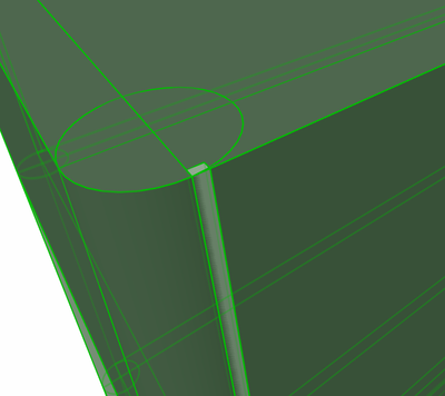

This is the resulting object:
I'm doing something wrong, I'm just not sure exactly what... 

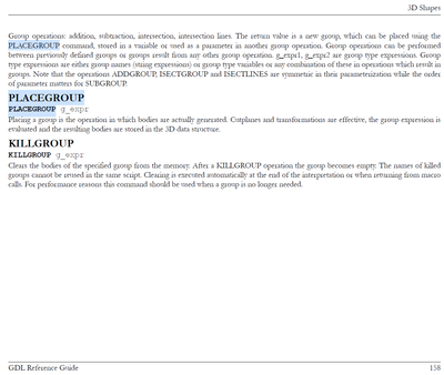

you may just want to just place the result of the subgroup...
placegroup subgroup("topsection","topgrooves")
remember to killgroup all groups at the end of the code.
killgroup "topsection"
killgroup "topgrooves"

Try ...
topgroup =  subgroup("topsection","topgrooves")
placegroup topgroup
