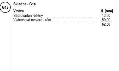

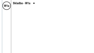

In a label this SLAB_SKINS_BMAT_NAMES parameter "breaks" when listing the 8 or 9th skin (and further skins). Works as expected in 7 or fewer. Tried it with a very dumbed down version of my label, simple rows with: text2 0, "manuallychangedposition",SLAB_SKINS_BMAT_NAMES [manually changed id][1]. If a slab had 4 skins and I wanted to print the 7th skin, it printed nothing, which is correct, no 7th skin, but if i wanted to print the 9th skin the label started to look like a dot - missing object, even if i added lower skins for the function to read, once i added the 9th skin, it always showed only a dot. Unless the slab had acces to the 9th skin, in which case it broke on the 10th skin.

This is when its working
And this is when i try to list from a slab that has 8 or 9 + skins

So when the label fails to generate, it does not return an error message? Odd...
