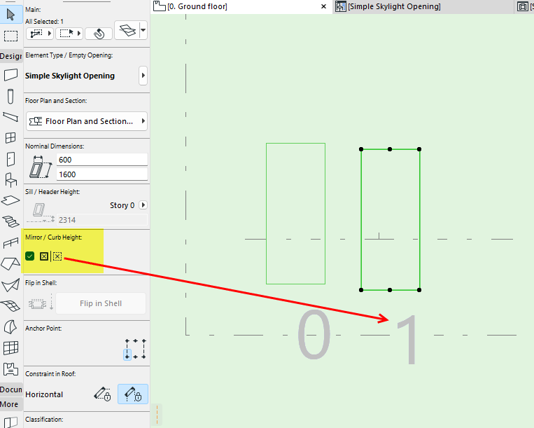

Sensing skylight for being mirrored and output to parameter
I need to apply a different parameter to a mirrored and not mirrored skylight/roof window.
Is there any possibility? Otherwise I will have to hard-code the type and un-mirror the model.
SYMB_MIRRORED does not work in parameter script.
WIDO_ORIENTATION does not work in skylights - it works ok with wall doors and windows.

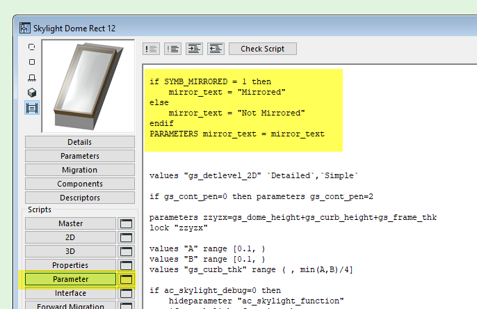

It is SYMB_MIRRORED.
Are you sure it doesn't work?
I just used it in the Master Script as a text value and it worked fine.

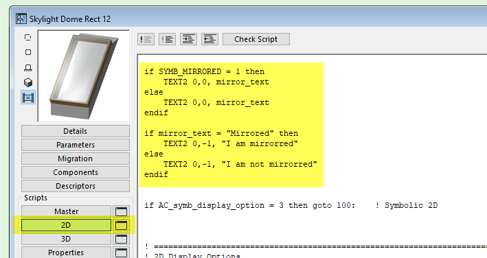

SYMB_MIRRORED works only in 2d/3d scripts.
It does work in either the parameter or master script.
At least it does pass a value on to another parameter.
You just can't set the value of that parameter in the parameter list.
I am not quite sure why.

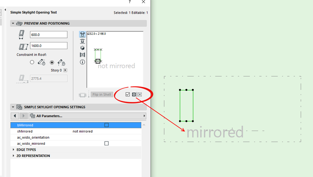

Barry, I cannot make it work, Yes it works if placed as an object, but not if placed as roof window.
I see You use AC 22 in the screenshot - so here goes a 22 version of modified file, maybe something stupid i did..
I added:
if SYMB_MIRRORED=1 then bMirrored=1 else bMirrored=0
if SYMB_MIRRORED=1 then sMirrored="mirrored" else sMirrored="not mirrored"
parameters bMirrored=bMirrored!: lock "bMirrored"
parameters sMirrored=sMirrored!: lock "sMirrored"
and bMirrored and sMirrored as parameters...
It seems I have to live with it and make a workaround with 2 different products L/R ones and then mirror / unmirror accordingly in the model  😞
works when placed as object, but not as window...what the heck?
The object behaves correctly.
It is just that the parameters do not adjust in the parameter list when you open the object settings.
I don't know why this is.
I was using the skylight tool.
I just added .... text2 0,0, sMirrored  ... in the 2D script of your object and you can see it does know when it is mirrored - it just doesn't show in the parameters.
this "just not showing in parameters" is what I need for applying the product name   😛
