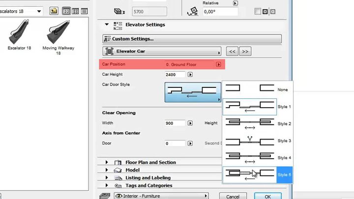

I have an object in my hand. I want to make a gdl object where I can choose which floor level this object will be at. However, I could not write a suitable code for this. There is the feature I want in the elevator object, but the gdl codes were too complicated for me. Which command should I use for this?

Obviously I tried that, but that's where your problem starts. What I want to do is to create a parameter that I can choose between. Ground Floor Plan, 1st Floor Plan, 2nd Floor Plan and link the position of the object to that floor. With the code you mentioned, I can get data such as story name or story height. I can also write it to the screen with the Text2 command. However, I cannot create a parameter that I can choose between them. Is there a sample video you can suggest about this? Creating a parameter similar to the “car position” parameter in the elevator object.

If you want to move the car then I would do it like this :
- Have an CarElevation parameter (length type)
- Have a CarPosition parameter (integer type)
- Request the story names and elevations after you requested the story info) and use VALUES{2} to display them as a drop down menu
- After selecting the CarPosition, calculate the sum of the elevations up to the chosen story
- Give that value to the CarElevation parameter to move the car

Thank you both very much for your response. However, I think I asked my question wrong. The question I am looking for an answer to is to create an infinite loop “values{2}”
i.e.
values{2} “stryname” , 1 , Ground Floor Plan,
2, First Floor Plan,
3, Second Floor Plan
I can write this manually, but depending on the size of the project, sometimes it can be a 10-storey project, sometimes a 20-storey project. Every time I add a new floor to the project, I want that stories to be added to the parameter automatically.
