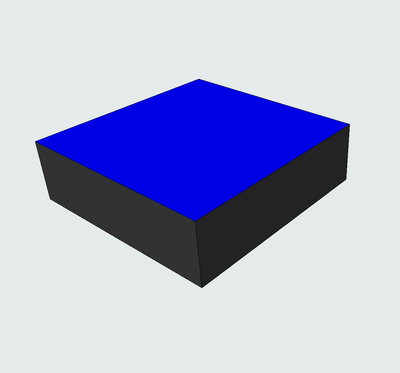

Hello all,
Hope you're pushing GDL towards to it's potential. Here's my issue at the moment. Why are my edges black? E.g. with SYMB_MAT this does not happen. Does the material definition need additional parameters for the cprism_{2} edges?
Kind regards,
Paalanen
define material "mat_test" 3,r,g,b
!mat_test = SYMB_MAT
cprism_{2} mat_test, mat_test, mat_test,
5, .3,
0, 0, 0, 15, mat_test,
0, 1, 0, 15, mat_test,
1, 1, 0, 15, mat_test,
1, 0, 0, 15, mat_test,
0, 0, 0, -1, mat_test

Version 2 of cprism does not know about locally defined materials, so this won't work.
Use cprism_{4} for that.
Also it's good practice to not use string literals. Instead convert them to local index numbers with IND().
Like this:
define material 	"localmat" 	2,
			0.329412, 0.4, 0.690196
id_builtin_mat = ind(MATERIAL, "localmat")

Hello runxel,
Thanks a lot indeed!! Will try cprism_{4}...
