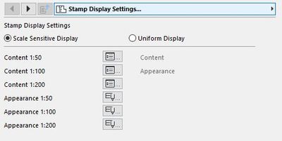

Stamp Display Settings
My question is, how can I add scale in the stamp display settings. The default  of content is 1:50, 1:100 and 1:200. I did a custom scale of 1:75 and 1:25 and I would like this to be added to the scale sensitive display.

You would need to edit the Zone Stamp, which would require knowledge in how to code in GDL and is impactical. Would be easier to just use a seperate stamp for your two custom scales.
Steve Jepson
yes. or even a Zone Label   ?
