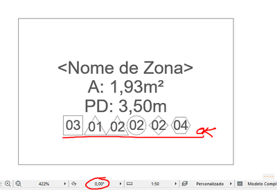

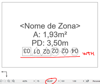

I've recently observed an issue with a zone stamp I created, where a portion of the text is not consistently readable. We utilize a call parameter to retrieve property values for text, but only this specific type of text seems to be problematic, if the view rotation is over 90 or less then 270 it became inverted. The other text elements function as expected.
Could there be an issue with the call parameter for the property, or is there another factor causing this inconsistency?
The codes for those texts are:
call    "Rótulo da Propriedade 26", PARAMETERS A =            A,
        AC_TextFont_1 = "Aria", AC_TextSize_1 =          1.5, AC_bLabelAlwaysReadable =      1, AC_TextCharSpaceFactor_1 =            1,
        AC_TextAlignment_1 =      2, iArrangeContent =		1, i1stRowContent =     13,
        iIDText1 =      3, stPropertyID1 = "41953892-31D4-4EDA-BC0A-EB719EF1BB72",
		distanceLabelHead_mm =       -1.3, bShowLeaderLine =      0
And here are some pics:

Are you able to show the scripts where you are placing that text in the object?
 To ensure text is always readable there are some if else statements to the object/label rotation and then flip the transformation stack 180deg before placing the text.
I’m predicting the text on your bottom row is missing this rotation, or is implement incorrectly. The call across just return raw strings of text so contain no rotation data.
