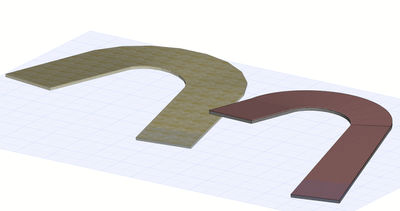

I am creating an object that will be a parametric car ramp using a tube command as a base of geometry. The geometry is then cut to parametric outline in plan to fit the needed geometry.
And I found out that tube command (1st or 2nd) is buggy as hell with alignment of the geometry parts.

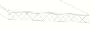

It is not visible from the outside, but doing a section reveals the "secret". Easy to check with the railing tool with the profile of the slab 3m wide with 2 layers one finish - 5cm and base - 20 cm.

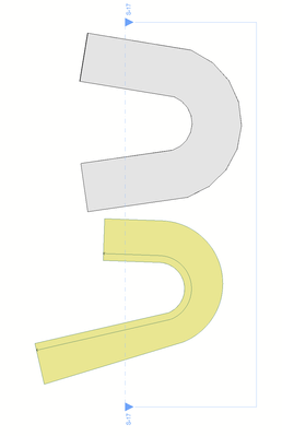

The left is a non cut one the right is using the cut to fit the outline.
Plan i rotated 90 deg from what is seen in 3d
Here goes the section of the non cut one:
The outside is aligned...but not what happens inside.

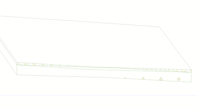

But when it is cut it becomes even "funnier":
