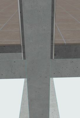

I've created a wall accessory and a sloped slab accessory but there is a problem with how they interact with the rest of the model
For the wall accessory, I've used the uwbp and uwtp trick to make them react to slabs and other elements connected to the top and bottom of the wall : elements like slab (with the slab tool)
My question is (if possible) : How do I make them react to other elements like other slab accessories ?
Below is a screenshot of a native concrete wall with my wall accessory, native concrete slab with my sloped slab accessory.
The connection between the wall accessory and the slab accessory is what I'm trying to fix.

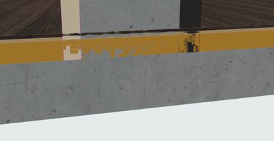

And in 2d - section
The problem is the same with ArchiCAD native wall and slab accessories (see below)
For top connected element, like the slab of the next story above, I don't have that problem.
But for any other elements (like ceiling), I had to use SEO if I want to achieve a similar result so I added a control hotspot to change the height of the wall accessory

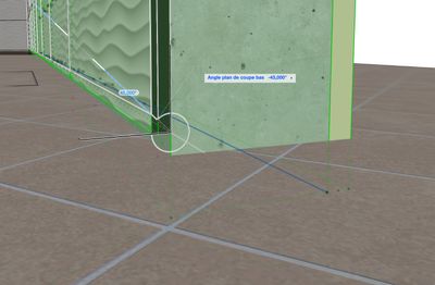

hi Team.
I dabbled with such case as well & it be solved by pure GDL alone...sadly.
My work around is to employ an adjustable  CUTplane command at top & bottom of the "wall accessory".  I also provided a 3d graphical hotspot  , which i can adjust in section or 3d view. I manage the typologies of these wall objects with respect to room application (toilet vs. office vs. units w/o ceiling or flr finishes) using favorites.

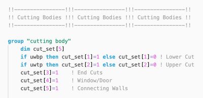

In the ArchiCAD wall accessory, there are parameters to control the top and bottom cuts of the shape
Here was my thoughts process.
Since there are ways to cut the wall accessory based on interacting elements (ie slab in contact of the wall, other connecting walls, etc.), I was looking for :
  • A better understanding of how that function works
  • How could I use that to my advantage with other non specific objects
I started with testing every native ArchiCAD tools and objects that would interact with my accessories
Then, based on my finding, tried to add to that list new cut_set variables.
I should specify that I still don't understand the exactly how this works but since it's a fixed array, I could add more to dim cut_set[i] but there are two issues :
  • How would ArchiCAD knows that cut_set[7] is for my ceiling slab and cut_set[9] is for skirting boards (plinths)
  • How could I specify the cut I want from that. In the base object, that cut is a basic SEO (substraction) but I want, for the ceiling as an example, a substraction with upwards extrusion
In the last image (with Next story up), the ceiling is a basic slab but the wall accessory doesn't react to it like it does to the slab above so it's not exactly the type of elements that determines the cut.
And if it's not the type of element, it might be the position of the element.
So I started moving slabs left and right, up and down, only to realize that the building material of the element was also a criteria for the cuts...
hi Team.

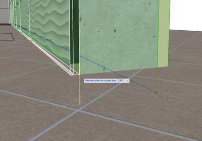

B_Migito
I don't mind the solving with GDL part, but I would have liked to automate the process and not have to do it myself.
I also used a graphical hotspot for the height (top) and I wouldn't mind using the same for the base (bottom) but that would mess up my tiles layout
I'll try to find out more about the automatic SEO. It might be a taller order than I can handle but I would like to try
If I'm not mistaking, modifying the Wall Cutting Body.gsm should give me the result I'm looking for...given that I understand how it works haha
