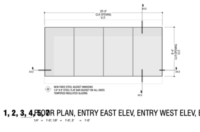

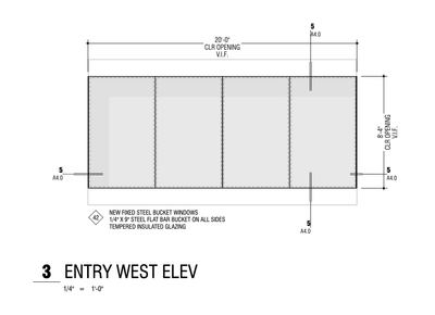

We have been using a custom drawing title object since AC20 with no issues. Now that we are using AC25, the title is behaving correctly ON SCREEN, but when we print or save as PDF, the title object displays the information for ALL drawings on the layout.
Need help solving this. GDL script below. Thanks!
correct display on screencorrect display on screenissue when printing or saving to pdfissue when printing or saving to pdf
