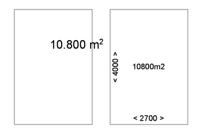

I am a newbie in coding. sometimes i try to cook something but i end up spoiling the broth. i spent the last 30min reading the gdl editor on strings and integers but that thing is way to complex for me.
I am trying to change the units of the value of AxB but i cant seem to find it.
this is my object and now the area, which is no more than AxB is in millimiter but i want it in meters
this is my code

Can anyone help me please?

@lmcardoso metric GDL coding is in meters by default, so you text should be...
TEXT2 A/2, B/2, "" + STR((A * B), 8, 3) + "m2"

so maybe i am miss understanding, but if you change the code to
TEXT2 A/2, B/2, ""+STR(1000*(A*B),1,0)+"m2"
does this not get what you want?
lmcardoso
i tried but that no it doesnt solve the problem. I guess its the units that are not right
what it should appear is 10,8m2 instead of 10800.
on your left a fil showing the area and on the right my object
ArchiCAD 23/25/27 with Win 10
okay try this
TEXT2 A/2, B/2, ""+STR("%.3m",(A*B))+"m2"
