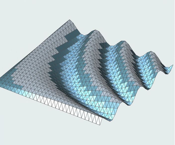

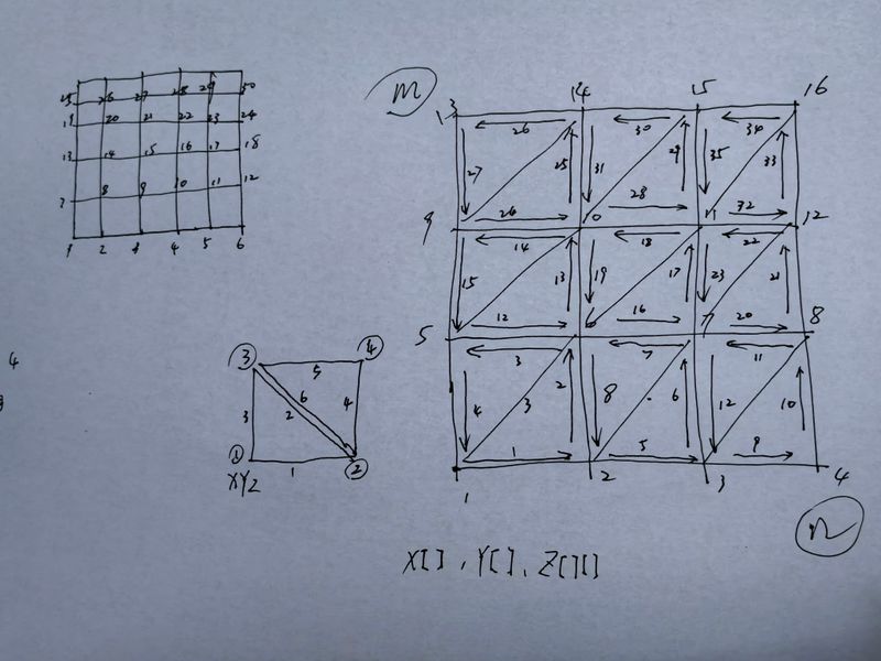

After two days of contemplation and experimentation, I seem to have learned some about how VECT, EDGE, and PGON operate.
2024-04-03 08:10 AM
 lin_pen = 2
 mat1 = 115
 mat2 = 425
 mat3 = 29
dim x[] ,y[] ,z[][]
x[1] = 0
y[1] = 0
m=  30
n =  30
for k = 2 to n
for  i = 2 to m
	x[k] = x[k-1]  + 0.15
	y[i] = y[i-1]  +  0.15
	z[i][k] = 0.25* sin( i*K*(4*360/(m*n)))
next i
next k
base
for  k = 1 to  m -1
for  i = 1 to   n -1
		vert{2}  x[i] ,       y[k]  ,  z[i][k],    0
		vert{2}   x[i+1] ,  y[k]  ,    z[i+1][k],  0
		vert{2}   x[i] ,      y[k+1]  , z[i][k+1], 0
		vert{2}   x[i+1] ,  y[k+1]  , z[i+1][k+1], 0
	pen lin_pen
	edge  1,  2 , -1, -1,    2 !   1+2+4+8
	edge  2  ,3 , -1, -1,    2  !   1+2+4+8
	edge  3 ,  1  , -1, -1,  2  !   1+2+4+8
	edge  2 , 4  , -1, -1,  2  !   1+2+4+8
	edge  4 , 3  , -1, -1,  2!   1+2+4+8
	edge  3 , 2  , -1, -1,  2 !   1+2+4+8
	 IF z[i][k]< -0.15  then material  mat1
	 IF z[i][k] >=-0.15 and  z[i][k] < 0.1   then material  mat2
	 IF z[i][k] >=0.1    then material  mat3
	pgon 3, 0, -1, 1,2,3
	pgon 3, 0, -1, 4,5,6
body -1
	next  i
	next  k
2024-04-06 10:05 AM - edited 2024-04-06 10:07 AM
Primitive elements can control the material representation of each unit of the surface, thereby expressing the analysis of mountain elevation, slope, etc. The GDL script is still being further optimized.
