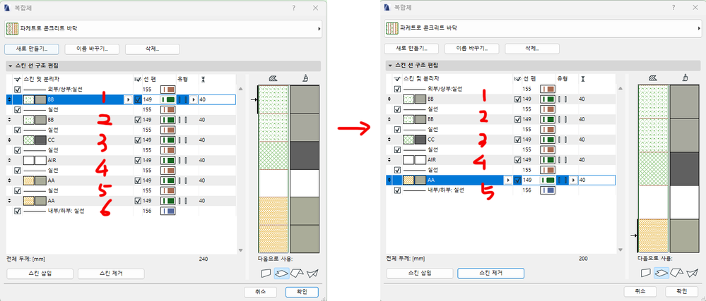

While making the label for slab complex, I found that the number of skins added to the complex was not automatically reflected.
after modifying the complex, Parameters reflecting the number of skins in the label are not reflected.
I tried to update this numText parameter to the current state by itself, but my ability was not enough.
It is updated only when I enter the settings and do some changes.
