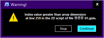

index value greater than array dimension
LeeJaeYoung
dim  WallskinThk[4]
WALL_SKINS_NUMBER = 4
i use WallskinThk[4]
Sometimes the error message doesn't come out, then it comes up again.
Saving is possible, but it doesn't feel good.

Assuming you always want the last skin,
WallSkinThk[WALL_SKINS_NUMBER]

The array is defined by the number of skins in the wall. So if at any time it's related to a wall with less than 4 skins you will get this error
So how should I set it up?

if WALL_SKINS_PARAMS[idx][SKIN_CORE_STATUS] > EPS then
            cumCoPen = WALL_SKINS_PARAMS[idx][SKIN_CONT_PEN]
endif
PEN cumCoPen
Error occurs here too.
What should I do?
