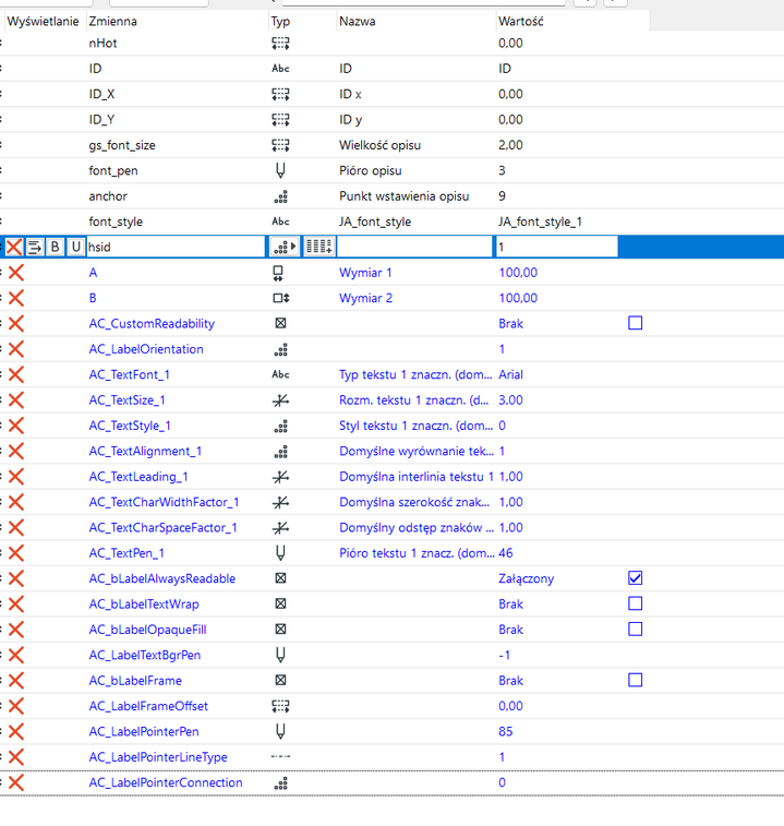

parameters in editor:
ID, ID_X, ID_Y, gs_font_size, font_pen, anchor, font_style

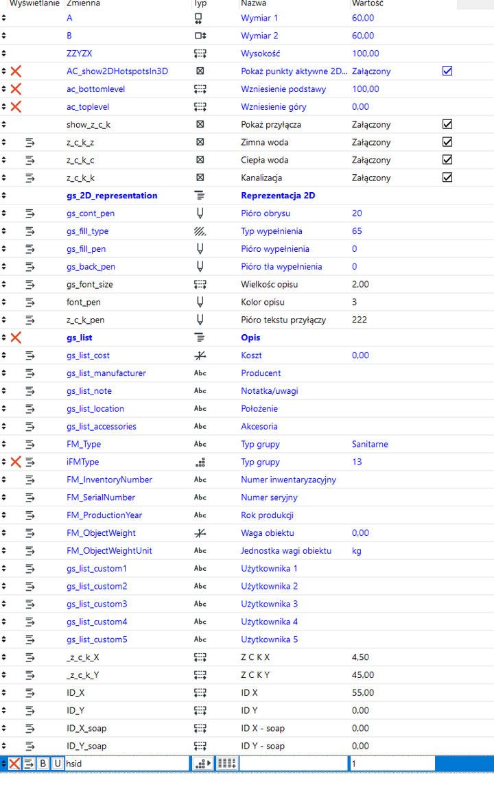

in parameters i have ID_X_chair, ID_Y_chair, _chair_ID and others

You should have the same Parameters in the caller as in the macro. E.g. if you add ID_X and ID_Y as Parameters in the caller, the you will not have this error message, even if you do not use this parameters.

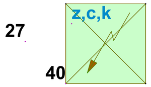

second fact is that when I create different hotspots in label with different coords, then it all move same label even if I place it in different location when I move label 1 it move label 2 with one hotspot.

It would only need to be ID_X and ID_Y that would be added to the host object, that is overrided with the desired value when you call the macro.

Every time you call the macro, you have to pass on different parameter values to the same parameter.
So for the mirror you would call with the parameters ID_X = ID_X_mirror, ID_Y = ID_Y_mirror
And for the sop dish ID_X = ID_X_soap, ID_Y = ID_Y_soap

I did that, but that doesn't work properly.
When I try to move second label with it hotspot, it move first label instead.

It wasn't clear if you have assigned different hotspots for each label. And don't think you can define the hostpots in the child, need to be in parent, you could make it an array in the parent to be tidy. ID_X[][3], ID_Y[][3]
The macro call places the child object using the parameters (or values) assigned to it. If you want to call the same macro twice and act independently they need to use different parameters in the parent object.
So in your parent object you need different X and Y parameters for each label. Then when you call the label you assign the parent hotspot to the child. So...
