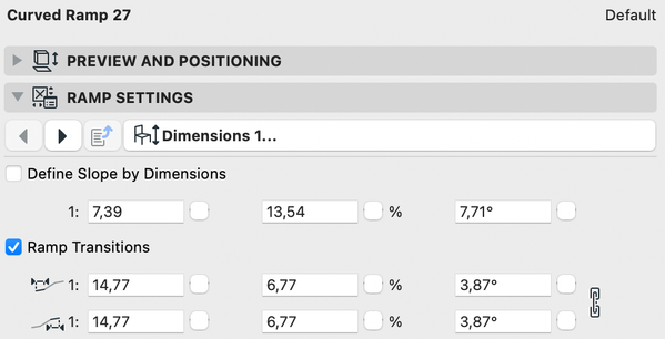

Is there already the possibility to use percent parameters, that show the % at the end of the number, like the angle parameters show the ° at the end of the number?

AFAIK, there isn't a parameter type for percentage. Eg. the Curved Ramp object uses real numbers.
Domagoj Lukinic
There is no percent parameters in GDL, like vlahtinen posted If you want a percentage it needs to be a real number. For exampe when you code a fall label for roof pitch, you take the angle and convet it to percent.
values "pramName", TAN(ROOF_ANGLE)*100
