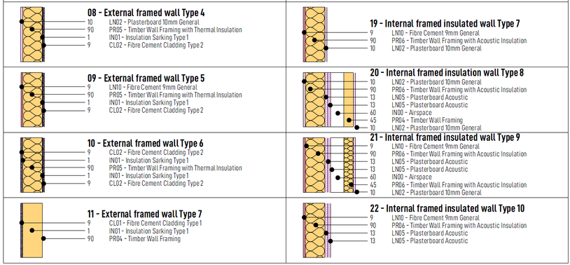

An example of a workflow I use currently is a wall type schedule. In plan I will use a custom label to tag each wall with the start of the Composite Name (before the first space). And then I create also in plan a series of short wall segments to represent each wall type that I have in my project. Each composite is labelled with a custom label once again which breaks up the skins and their thickness together with the full composite name and arrows pointing to each skin. The label that we had at Fulton Trotter was 10 times more over the top than this one as it included fire ratings and smoke ratings and R Ratings for external walls.
This is only one workflow I use now and have held off doing anything more because of limitations with having mixed tools doing similar tasks. I somewhat feel like the ability to script custom labels is what is holding me back from pushing this any further. I also am not a fan of Archicad Properties yet because they are handled at the instance level, if they were handled at the Composite and Complex Profile level then I would look to use that information in my workflows. The problem with instance based properties for composites and complex profiles is that if you change it the properties do not automatically change with it, so there is a potential for information conflict.
With all of the discussion about key notes, I think they are old and not really needed, if Archicad properties are addressed properly across all attributes then that information could be used to tag, note, describe every element that is placed in the model across plans, sections, internal elevations and even details.
The challenges with schedules, is a big one because you are not able to get all of the information in a single schedule for all element types, which forces you to either model things using a single method, or you end up having to create multiple schedules and then sit them below one another. I honestly have put as little information into Archicad as I can and use Attributes as my single point of truth and have the rest of the information in my specification, because of these problems within the software.
The main area without thinking of every possibility right this second would be where you change the scale of a drawing. At 1:100 you want to see a wall a particular way, at 1:50, 1:20, and 1:5 you would want to progressively see more detail or clarity or separation. At the moment I trick this with pen sets and graphic overrides.

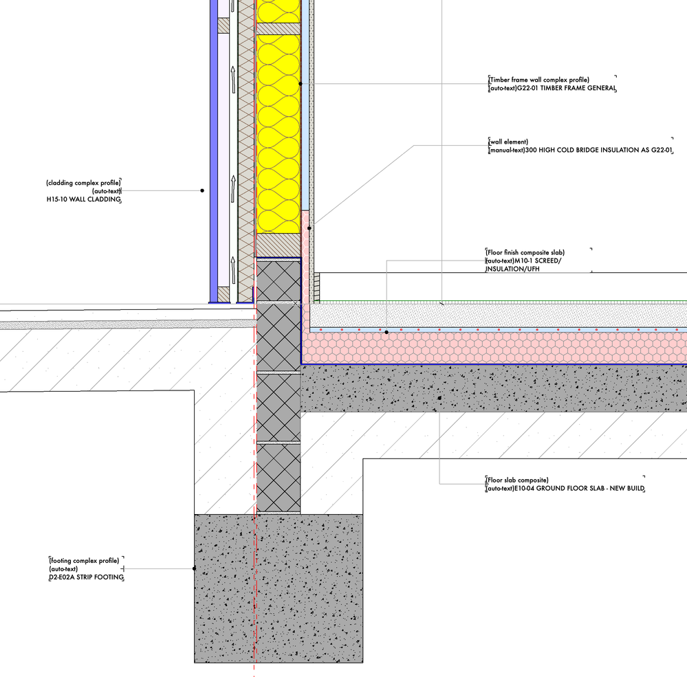

See attached screenshot of a typical 1:10 scale ground floor detail that uses complex profiles and composites.
  • The wall detail between the footing and the timber frame wall is a complex profile that interacts with the edge of the slab which is a composite
  • The timber frame complex profile includes
    blockwork above floor level
    insulation between the frames
    Internal service void and vapour barrier
    Internal plasterboard and plaster finish
    So it's all quite a complex area to manage
  • All the elements have property data attached that is used to generate the auto-text drawing notes. The same property data is included in the specification that also includes more text that does not need to show on the drawing
So as you can see there is huge potential for enhancing the creation of the complex profile geometry and also the data handling. These improvements would help with live detailing immensely. I don't use the detail tool at all, but I also don't draw any 2D for my details.
