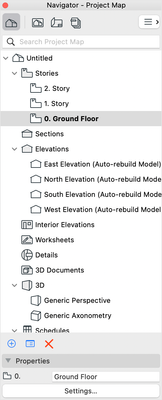

Navigator
One tree for all of the project's Stories, 3D, Sections, Schedules, Views, Layouts, Publishing.
Drag a View onto a Layout to create drawings in seconds.

Navigator
  • Each story/elevation/section etc. in the project is listed in the Navigator’s Project Map
  • To create new stories, go to Design > Story Settings
  • To create sections/elevations, find viewpoint tools in the toolbox

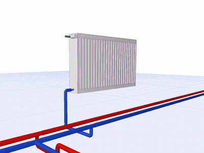

MEP Route creation
MEP Routing allows you to create connected systems of ducts, pipes, or cable carriers with continuous mouse clicks, similar to drawing polylines -but resulting in 3D MEP elements.
  1. Select Duct, Pipe, or Cable Route tool in the Toolbox with one click
  2. In Settings: Pick the MEP System, Nominal Size, elevation, and shape
  3. Click to start routing, then click for each change of direction, Esc to finish or double-click

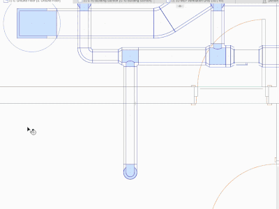

Edit individual parts
For editing individual parts of the MEP Route (nodes, segments), use  the "Edit Mode", available in both 2D and 3D .
  • Select Route Element: Click on any part of the route
  • Activate Edit Mode: Click the 'Edit' button that appears
  • Modify Components:
    • Segments: Adjust length, diameter, materials
    • Nodes: Reposition connection points, change angles
    • Junctions: Modify branch configurations
  • Exit Edit Mode: Press Esc or click 'Exit' button
The Navigator workflow
MEP_Navigator.pngThe Navigator serves as the central hub for organizing and navigating your MEP project. Its tree structure reflects the project’s logical organization, making it easy to move between different parts of your work.
Any new stories, sections, or elevations are automatically listed under the Project Map. Filtered versions of these can be saved as Views—for example, while the Project Map only allows a single ground floor, multiple variations can be stored  - each with with different settings - in the View Map. These Views can then be placed onto Layouts in the Layout Book and published in various file formats in the Publisher.
Tab What you store Typical action
Project Map Raw viewpoints: Stories, Sections, Elevations, 3D, Schedules. Create or open model views.
View Map Saved views with Layer Combo, Scale, MVO, Graphic Overrides. Organize working & print views.
Layout Book Sheets that hold drawing views. Assemble drawing sets.
Publisher Sets Output batches (PDF, DWG, BIMx). Issue deliverables with one click.

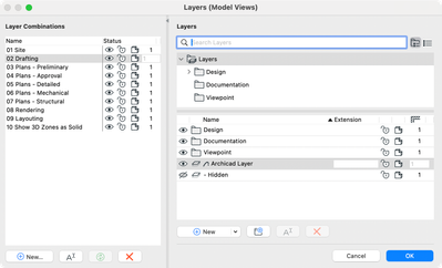

Layers & Layer Combinations
MEP_Layer_Setting.pngLayers are used to separate elements logically. Each tool has a default layer assignment: when you place an element using that tool, the new element is automatically placed on the corresponding layer.
An element can only belong to a single layer.
Layer Combinations are named sets of layers with varying statuses. Use these combinations to hide or lock layers that you don’t need to see or edit in a view.
Each view is saved with a particular Layer Combination.
To open the Layers dialog, do one of the following:
  • Shortcut: Ctrl+L
  • Layer Settings icon in the Quick Options bar
  • Options > Element Attributes > Layers
