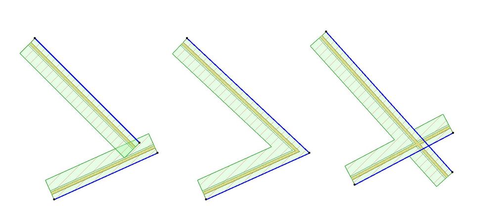

The first thing you have to make sure of is that the reference lines of the walls are connected. The reference line is by default not visible. It appears in blue when you select the wall or if you activate View > On-Screen View Options > Walls & Beams Reference Lines. In this case, a black line with an arrow will be visible even if the wall is not selected. What does the arrow mean? The arrows show the direction of a wall. For a proper connection, it is not enough that the walls collide, their reference lines must join or intersect.
The walls collide but their reference lines do not join and do not intersect The walls' reference lines join The walls' reference lines intersect
If you turn on the Auto-Intersect function (by default turned on), the reference lines of colliding walls will automatically be extended so that they join. You can turn this function on and off under the Options menu. TIP: If you want to intersect two existing elements with one click, select the two elements and use the 'Intersect' command

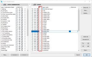

If you want to prevent certain elements from connecting, use the Layer Intersection Number. Every element in Archicad has a layer assigned:
  • If two walls belong to two different Layers with different Layer Intersection Numbers, they won't be joined.
  • Intersecting elements that belong to the same Layer Intersection Group (they have the same Layer Intersection Number) will be joined, provided they are drawn correctly (they join or intersect as discussed above).
  • Two elements that are both set to intersection group 0 will NOT be connected.
To change the Layer Intersection Numbers, open the Layer Settings Dialog Box. Go to Document > Layers > Layer Settings or use the shortcut: Ctrl+L.

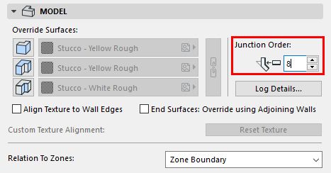

When 3 or more walls of the same priority meet (their reference lines intersect) in a junction, the junction is considered as a group of several two-way connections. The order of their connection depends on their Junction Order.
Set Junction Order in the Model Panel of the Wall Settings dialog.

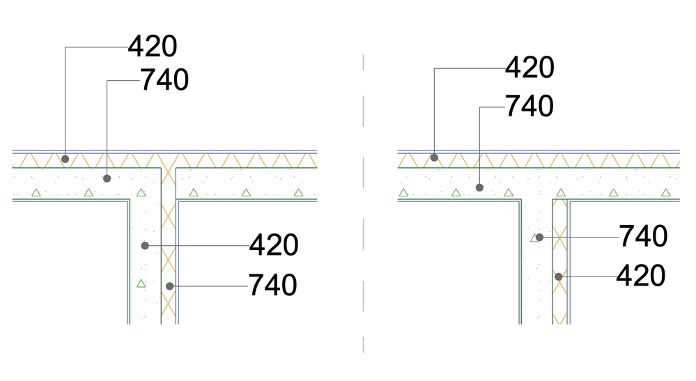

Priority Based Connection (PBC)
In case of composite walls, it is not enough to have the walls join, it is also a question how the different skins (insulation, concrete, etc.) connect, which material has the priority over the other. The different skins of the Composite Structures in Archicad are defined by Building Materials. Building Materials have an Intersection Priority value which is defined under  Options> Element Attributes > Building Materials.
The resulting intersection depends on the elements’ Building Material Intersection Priorities, set in the Building Materials dialog box. The skin with the higher Intersection Priority Building Material will cut the one with a lower priority.
Tip: If you select the composite wall and then you open the Building Material Dialog box, the used Building Materials will be highlighted.
