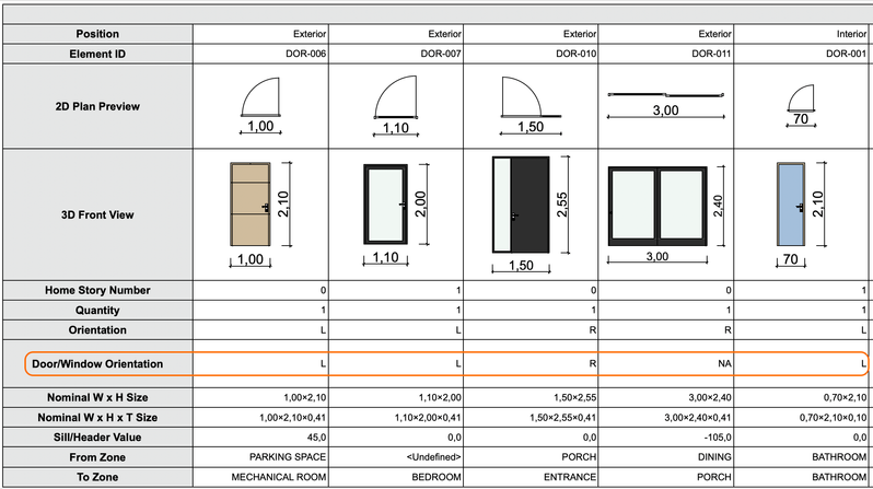

Now, let’s see the solution Ricardo and Barry proposed for customizing Door data to cater to special needs. In this scenario, we would like to personalize the text “R” that describes the door opening orientation for double-leaf doors and display “NA” (not applicable).

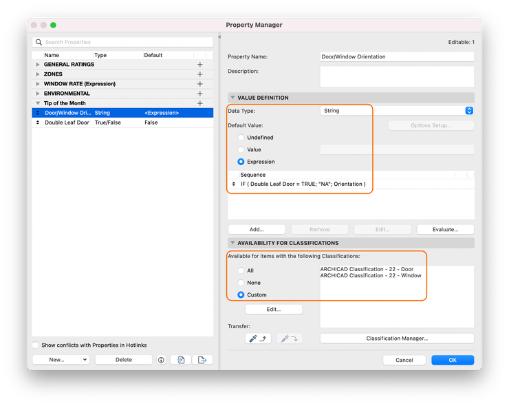

Start by creating two new properties for Doors (and Windows, if desired):
  • Add a True/false type to determine if the element is a double-leaf door and set the default value to “false”
  • Add a String type with a conditional expression as follows:
    IF ( {Property:Tip of the Month/Double Leaf Door} = TRUE; "NA"; {Property:Window\/Door/Orientation} )

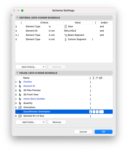

Next, open the Door Selection Settings dialog, and assign the “Double Leaf Door” Property to “true”, like this:
In your Schedule, add or replace the “Orientation” field with our Property “Door/Window Orientation”:
As a result, your double-leaf doors will display “NA” for opening orientation, while single-leaf doors will still refer to “R” (right) and “L” (left):
