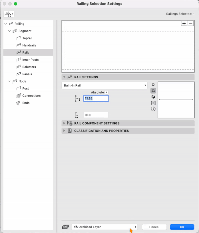

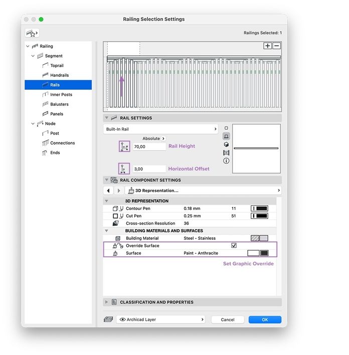

 Add hidden Horizontal Rails
  • Start by adding several Horizontal Rails in the Rail Settings.
  • In this example, the wave peak is at 100 cm (top Rail) and the trough/baseline at 90 cm (lowest Rail).
  • Add intermediate Rails at 90 cm, 93 cm, 96 cm, 98 cm, and 100 cm to give you enough vertical steps for a smooth wave.
Tip: Set the first Rail as hidden, and the additional Rails will inherit the same setting, so you only need to configure the “hidden” behavior once.

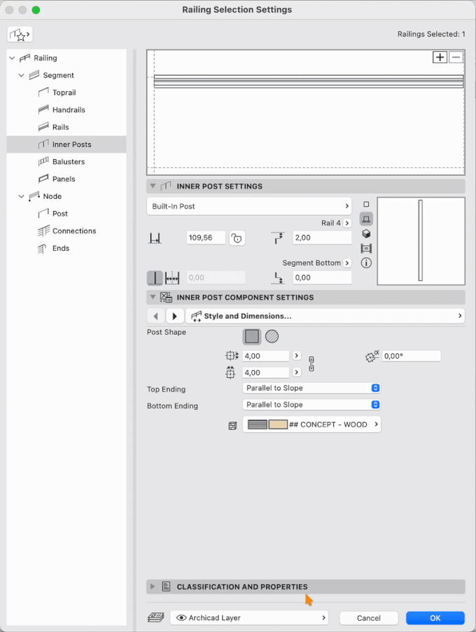

Place Inner Posts at consistent intervals and set their Top Offsets relative to the hidden Rails
  • Place the first Inner Post at the beginning of the Segment, with Distance from Previous = 0, so the pattern starts exactly at the start of the wave.
  • For each Inner Post you add, set its Top Offset right away, so it aligns with one of your hidden Rails. For example, the first post is offset to Rail 1 (90 cm, baseline); the next post to Rail 2 (93 cm), then 96 cm, 98 cm, up to 100 cm (the peak), and then back down in reverse order.
  • Then place the next Inner Post, for example, 8 cm away from the first.
  • Continue adding Inner Posts along the Segment, always using the same spacing (e.g. 8 cm) so the wave remains smooth and consistent, until you reach the end of one full wave period.
Tip: Once you add the first Inner Post, set its dimensions and material. All following posts will adopt these properties—saving you time.

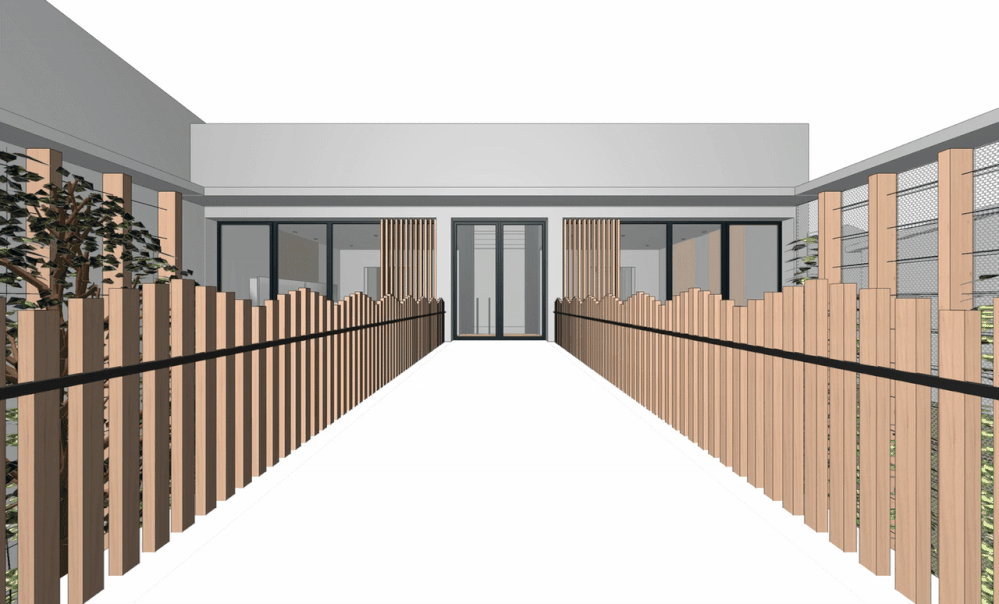

The result
You now have an editable, patterned fence.
GRAPHISOFT_Archicad_Sample_Project-Villa_Patio_v1.0_AC27-ezgif.com-video-to-gif-converter.gif
Once the first wave Segment is set up, the rest of the railing is just repetition. Adjust the spacing and heights until the wave looks right for your design and save the setup as a favorite if you plan to reuse it. If you try this approach on other custom profiles, share your results and tips with the Community!
