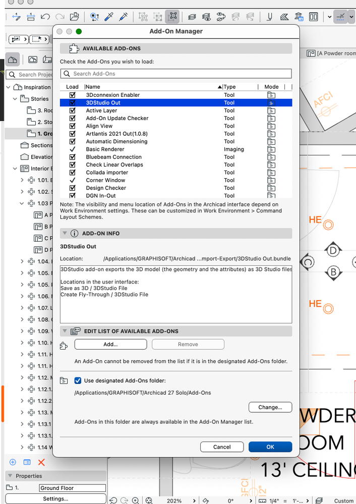

You have the '3D Studio out' add-on loaded but not the '3D Studio in' add-on.
The 'out' has no menus, it is simply 'Save As' from the 3D windows and change the file type to '.3DS'

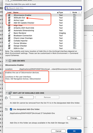

Your screenshot of the add-ons shows the 3DConnexion addon. Select the 3DS add-on and read at the bottom of that dialog where AC thinks the interface got installed. If not in an existing menu, then as Botonis said, you have to go to the menus in your Work Environment to add it to a menu. In the WE, display the menus alphabetically to find it.

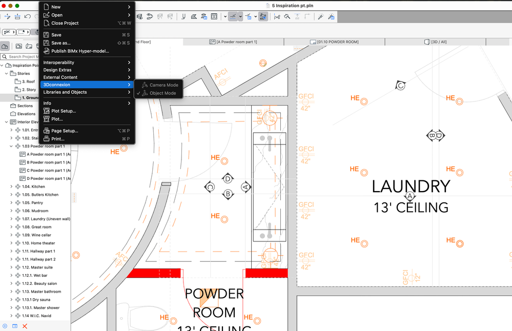

I am looking for 3D Studio per this photo . I see 3D connexion but it is grayed out (only show camera mode and object mode option but not usable).
I looked in the work environment - I searched the keywords but nothing except the 3D connexion which does not look like what I am looking for?:D

You didn't read my post. Here is YOUR screenshot:
I've added the red highlights. You have "3Dconnexion Enabler" highlighted at the top (whether intended or not) ... and so in the middle, circled in red, it tells you were in the menu structure THAT add-on can be found.
You need to click on "3DStudio Out" in the top part ... in order to read in the bottom part WHERE the add-on can be accessed. Please post a screenshot of THAT. 🙂

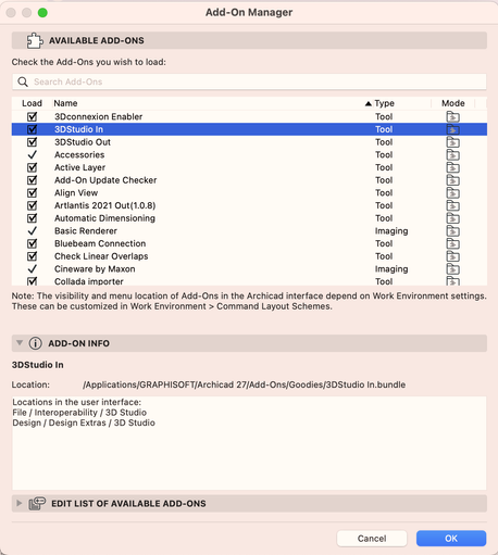

For 27 Mac ARM, this is what I see in Add-On Manager... I'm not sure why you do not see the 3D Studio In add-on as well as the Out add-on which does show on your Mac...

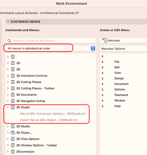

Here is where you will find the commands in the Work Environment dialogs. In my screenshot, the commands are in italics because they already exist in my menu structure. If yours are not in italics, then select the menu on the right that you want the commands to appear in and drag them from left to right.

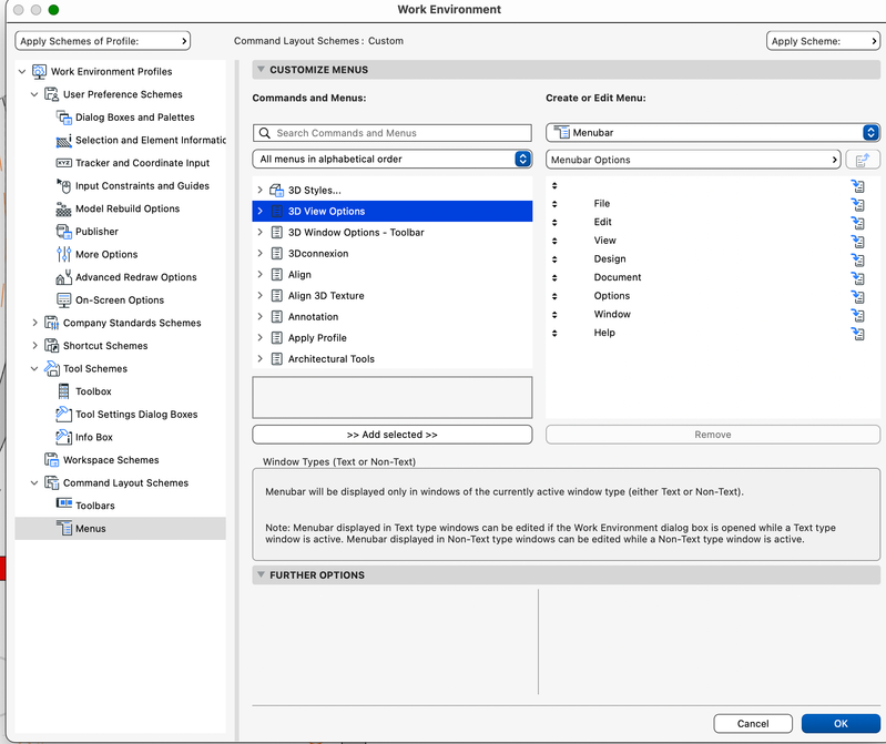

Thank you. Ok I am getting there 😄
1. allocated the 3dconnexion (moved into "file") (still don't know what is this for 😄 but I got it!
2. 3D Studio - I can't still see it! 😭😄 Here is all printscreen by alphabet. I tripled checked that I have it checked/on.
