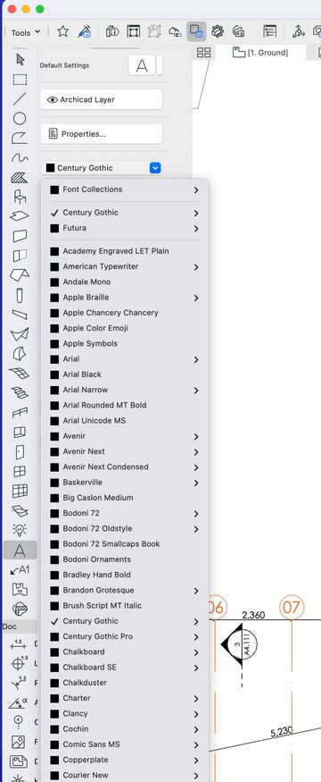

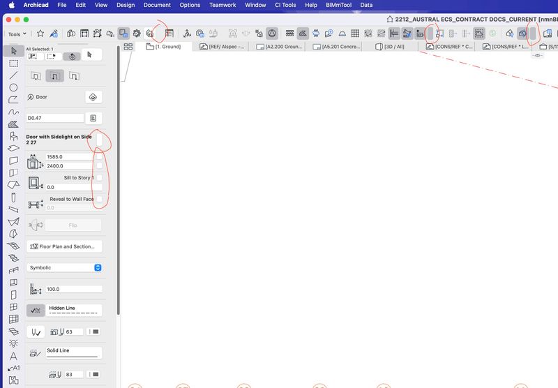

there are a number of UI bugs that have shown up since our office upgraded to MacOS 15.2.  these issues are present on multiple machines, both intel based and apple silicon.
1) buttons in toolbars, palettes, and the info box that are for dropdowns are missing the dropdown arrows.
2) font selection dropdowns all show black rectangles for all fonts
see the screenshots attached.

Hi Ben,
Just install the last Archicad 27 Update (27.3.1) : Download
Those bugs are already fixed.
