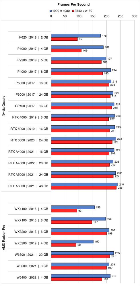

Graphics Cards tested with Archicad
Here you can see the results of how different graphics cards performed on a reference computer configuration with different monitor resolutions.
The measurements were done on a computer with CPU Single-Threaded Performance rated at 2194. The cards were tested using a small residential project (300.000 polygons), a high-rise building project (1,3 million polygons), and a stadium project (9 million polygons) on Windows 10 64-bit. Frame per second rate shows the speed of the graphics card measured while navigating in the 3D window of Archicad.
Apart from the graphics card's processing power, there are numerous factors that affect the 3D navigation performance. The computer's processor (CPU) plays a major role in 3D navigation. The CPU feeds the graphics card (GPU) with data to process and display. If the CPU doesn't feed data to the GPU fast enough, you cannot utilize the GPU's full potential. Thus it is important to pair a powerful GPU with an equally powerful CPU to mitigate CPU bottleneck. Please note that 3D navigation is utilizing a single core of your processor. That is why CPU Single-Threaded Performance is important for mitigating that CPU bottleneck.
Another factor that will affect 3D navigation performance, is the monitor resolution. The higher the resolution, the higher the strain on the CPU and even higher on the GPU. When the resolution is increased, the frame gets bigger and consequently, the more processing required the longer it takes for the GPU to finish the computation. That is why the speed (frame rate) drops with higher resolutions.
Another aspect often neglected is the memory size of the graphics card. When we open a file and navigate in 3D, the memory of the graphics card (VRAM) is used first, when it runs out then the Main Memory (RAM) is used. It is important to understand that your computer's memory is much slower than your graphic card's dedicated memory (VRAM) for 3D operations. So storing data on the computer memory (RAM) for 3D operations is something that should be avoided. To prevent that from happening we need to make sure that our graphics card has enough memory (VRAM) available to handle our model. There is no rule of thumb to estimate how much memory we need. We cannot draw a parallel between the project file size and the graphics card memory usage. Archicad stores the model information of the objects' parameters, and not by the coordinates of the polygons. Huge files that have a lot of parameters might occupy a large amount of memory. And when the parameters of some geometry objects are set to large resolution or segmentation it adds an extra burden. Also, there might be a model that itself is only just a few kilobytes, but its parameters would use up a big portion of the graphic card memory in ultra high resolution with lots of large textures triggering slowness. We recommend 2GB of dedicated memory for small to average-sized projects, but if your work involves UHD resolution monitors with large complex models, your graphics card dedicated memory should be at least double.
The following graphics cards have been tested for Archicad. Please note that the cards listed below are selected as a result of collaboration with hardware vendors.
Small project (300000 polygons)
Medium project (1,3 million polygons)
Large project (9 million polygons)

Wow, comparing these benchmarks with Archicad 25, it looks like there is an almost double performance in terms of framerate with the same graphics card.
@Minh Nguyen Is this because of the switch from OpenGL 4.5 to Direct3D ?
I don't remember anything mentioned from the launch presentation about this huge performance bump, but it's definitely a good thing that I would have liked to know about 🙂
Minh Nguyen
Graphisoft Alumni
Graphisoft Alumni
Hi @Anonymous
Thank you for the question!
This improvement partly comes from the change to DirectX and partly due to our new testing method.
