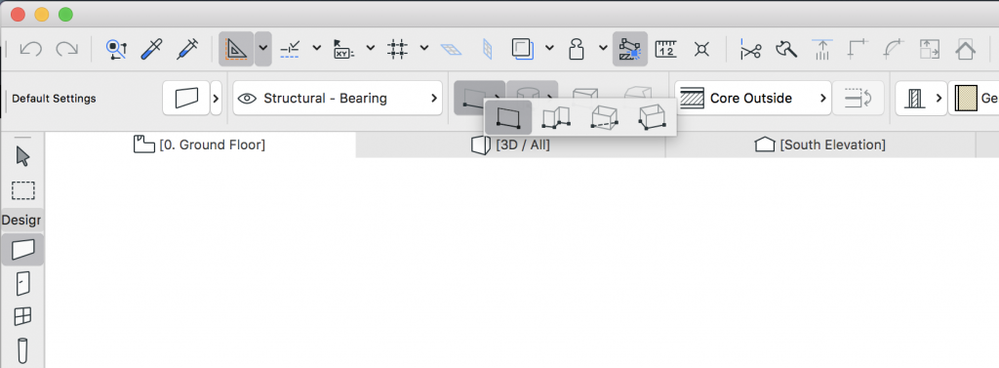

Issue
When you open a Push menu from a toolbar, ARCHICAD may crash. Unfortunately there's no workaround for this issue at the moment, we will fix this for ARCHICAD 20 and 21 in an update later this year.
Solution
This crash should be fixed in the latest Update for ARCHICAD 21 (build 5021) and 20 (build 7001). Make sure you have the latest update installed, and if you still experience the crash, contact your local support.
To download the latest updates use the Help / Check for Updates option in ARCHICAD or go to https://www.graphisoft.com/downloads/archicad/updates/
