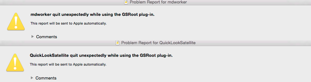

The GRAPHISOFT installed Quicklook Satellite and Spotlight Plugins can crash when opening ARCHICAD projects. These two Plugins help display additional information about Projects in the Apple Finder (preview picture, file version, platform where the file was created, other metadata, etc.).
The crashing of these plugins can cause general performance issues because the apple crash report system runs in the background quite frequently.
Cause:
The security policies for Plugins like the Quicklook and Spotlight became more strict on macOS 10.12 Sierra therefore the crashes are happening more frequently.
Solution:
Install ARCHICAD 20 Update (Build 4012) or ARCHICAD 19 Update (Build 7006)
