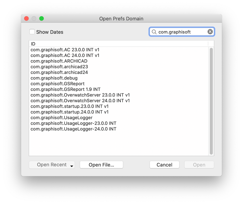

We will demonstrate the workaround using Prefs Editor:
  1. Open Prefs Editor.
  2. In the Filter search field, look for the PLIST by typing its name, in this "case com.graphisoft.AC xx.0.0 <regioncode> v1.plist".
    • xx is your Archicad version (23 or 24)
    • <regioncode> marks the language version of your Archicad.
    • An example: com.graphisoft.AC 24.0.0 INT v1.plist.
  3. Select the PLIST file. Click Open.
  4. The file is opened in a new window. Enter "geometry" to look for the required key.
  5. Put a tick for "DisableGeometryShader" checkbox.
Once the modification is made, it is automatically saved to the PLIST file. We can close the window and exit Prefs Editor.
To reenable Geometry Shader, we can go through the same process as described above. In step 5, untick the checkbox "DisableGeometryShader" to enable Geometry Shader.
