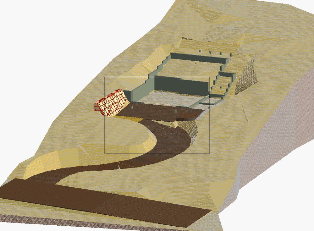

I have had good success working with the DXF file also. Except for yesterday... the DXF file that was sent to me did not have all the layers and therefore, not all the data points. The Surveyor did not include his the "Surface" layer in the DXF. He did not know my needs. I made a call to him and after a 5 minute discussion he E-mailed me a new DXF with only one layer and all the surface information. He said the layer contained what he called it a TIN data. It worked great. I had a Mesh within 15 Seconds of receiving the E-mail. And with the ArchTerra Tools I manipulated the site and added the Driveways. Attached is a JPG of a few projects.
Site with Foundation
Another site
Same Site w/ Foundation
Same Site view as before using the Internal 3D Engine. Slower image but can better see the grade changes.
