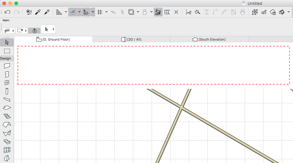

Upper part of the workspace may appear blank on macOS Sierra 10.12.4 Update (released on 03.27.2017) with Intel Iris graphic cards:
When switching to the 3D window ARCHICAD can become unresponsive & can crash.
The issues are present only with Macs having Intel Iris Graphics cards. Macs with dedicated (AMD/Nvidia) Graphics cards are unaffected.

All of the above issues can be circumvented with turning off the Antialiasing feature of ARCHICAD. To do so:
  • start up ARCHICAD
  • navigate to: Options » Work Enviroment » Advanced Redraw Options menu
  • turn off 2D Drawing Antialiasing & 3D OpenGL Antialiasing
  • click OK
  • Restart ARCHICAD (these changes take effect only after ARCHICAD is restarted)
