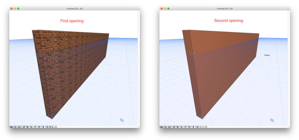

Textures are missing when you open the 3D window for the second time in ARCHICAD 18
Affected versions: 18 | Severity: workaround applicable | ID: 199690
NOTE: Fixed in ARCHICAD 18 Update Build 8004. If you close the 3D window (OpenGL, perspective), and open it again, the textures of all surfaces will be missing. The colors will still match, but there won't be any textures.
Workaround: You can leave the 3D window open in the background, and the bug won't happen at all. If it has already happened, you can fix it by changing the 3D Engine to Internal, and then back to OpenGL. You can do that by selecting the 3D Engine from the 'View>3D View Options' menu.

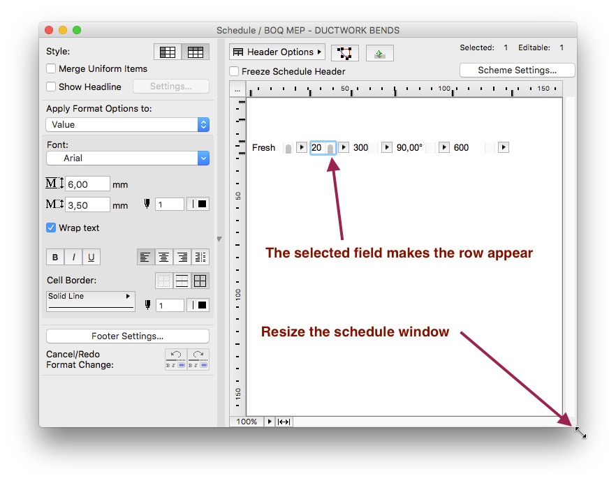

Interactive schedules are empty in ARCHICAD 18
Affected versions: 18 | Severity: workaround applicable | ID 196036
NOTE: Fixed in ARCHICAD 18 Update Build 8004. The interactive schedules are displayed as if they were empty when opened in ARCHICAD 18 under OS X 10.11 El Capitan
Workaround: Resize the schedule window. Reopening the schedule window is not sufficient, the content will possibly still be invisible, it has to be resized!

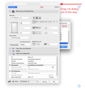

ARCHICAD becomes unresponsive, because second level dialog box jumps behind the first if you close a third level dialog box
NOTE: Fixed in ARCHICAD 18 Update Build 8004 and ARCHICAD 19 Update Build 5005.  Affected versions: 18 and 19 | Severity: workaround applicable If you open 3 dialog boxes (each one from the previous dialog box), and close the 3rd one, you might notices that the 2nd dialog box disappears, and you can only see the first one, but it's unresponsive. This is because the second dialog box jumped behind the first one, and that's the one that's actually active. Let's see an easy example to help better understand the problem: 1. Open a Default settings dialog (1st dialog) 2. Choose the "Favorites..." button from the top left (2nd dialog) 3. Choose "Save Current Settings as Favorite" (3rd dialog) 4. Cancel the upcoming dialog 5. The 2nd panel should be behind the first one now Workaround: You can either drag the first dialog out of the way to reveal the active dialog box, or just press CMD+TAB twice.

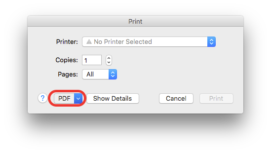

ARCHICAD 18 and Start Edition 2015 can't save texts on PDF, when using the Save As... option
Affected versions: 18 and SE2015 | Severity: workaround applicable | ID: 194376
NOTE: Fixed in ARCHICAD 18 Update Build 7007. This issue is also fixed in the Temporary Compatibility Update. If you try to use the Save As... option to save a PDF in ARCHICAD 18 and SE2015, texts (Text, Dimension Text, Label Text, etc.) won't be saved on the layouts. Workaround: In ARCHICAD 18, the publisher saves PDFs correctly. In SE2015, you can use the Operating System's own PDF saver tool from the print dialogue.

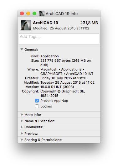

App Nap
Affected versions: 19 and older | Severity: workaround applicable | ID: 189288, 193425 App nap is a great  feature to help to save battery life. When this feature gets enabled, applications that run in the background will be slowed down. There are situations when ARCHICAD works in the background (e.g. drawing update) and you would like to run it on full speed. Workaround: To keep ARCHICAD alive in the background; disable App nap for the ARCHICAD.app. This is highly recommended for all Teamwork (BIMcloud, BIM Server) users.
  • search for the ARCHICAD applications in Finder: ApplicationsGRAPHISOFTARCHICAD <version>ARCHICAD.app
  • select the app an pull up the context menu, by right click or ctrl click
  • select Get Info
  • check Prevent App Nap checkbox
If App Nap is on, and you are working in Teamwork, App Nap might terminate the connection with the server, and you might even need to restart ARCHICAD in order to get it online again. App nap should be turned off for BIM Server Manager and BIM Server Control Center (applications in the BIM Server folder) because App nap might prevent the server to run smoothly. v18+ BIM Server and BIMcloud is not affected.
