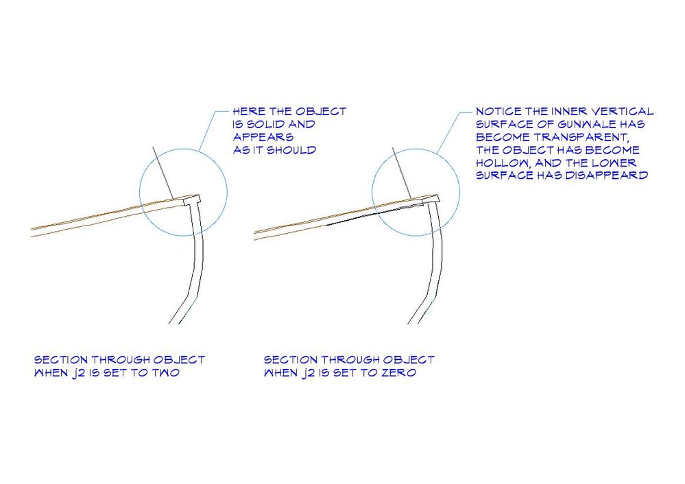

In the CUTPOLYA command you have a choice either one or two.
In the CUTFORM command you can set both independently and
if you set one to zero you can get some strange effects
like the cut surface becomes transparent.
(edit) Actualy what happens is if j2 is set to zero then the object
becomes hollow, some surfaces become transparent, and
some surfaces dissapear.

Frank, have you seen the strange effect I described when
f2 is set to zero ? This is seen in the Section/Elevation window
when the object is cut by a section line. See image below.
I will have to see what you mean about the consequence
of alternate f2 settings on the PROJECT2{3} command.
