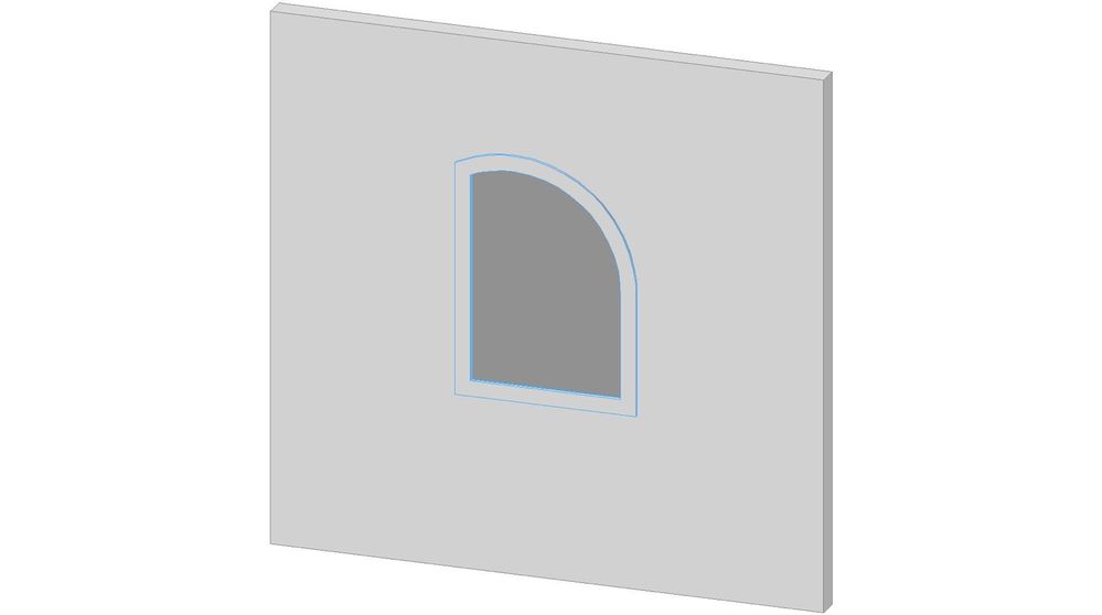

Arched window with unequal legs is similar to the quarter round window, except the curve does not terminate at the horiz. member. Instead there is a vertical leg like on the opposite vertical size, except the vertical dimension is different. The top arc of the window connects the two legs.

Try Petri's "Free form Window" object found
in the Depository under doors and windows.
I made an arched window with unequal legs
using Petri's object. It worked very well.
I drew the frame shape with lines and arc,
set the magic wand settings for the resolution
of the arc and set "straight segments" then
magic wanded the lines and arcs with the
polyline tool selected. I copied this polyline
into the Section/Elevation window and placed
it in front of a wall,in plan I inserted Petri's window
into the wall, went back to the Section/Elevation window
and using the editable hotspots shaped the window
to fit the polyline. Please see attached.

Peter,
So the image you're showing has no curved lines? Just little segments? Great trick. Any idea if there's a better solution in future versions? I'm in v11, so I assume not, but I have a feeling I'll see this same problem in v14 later this year.

Hello Jared,
As you know, In Archicad all curves in 3D are resolved
in to short straight segments. This is true of all tool elements,
library parts, or any element that has a 3D representation.
You can verify this assertion by looking carefully at a curved wall
or curve edged slab in the 3D window and you will see that
the curve as drawn in the plan as a true curve is resolved into
short straight segments. AFAIK this is still true in AC 13 and AC 14.
One great thing about Petri's object is that you can create
as many hotspots or nodes as you want to make the "curve"
appear as smooth as you want.
Peter Devlin
