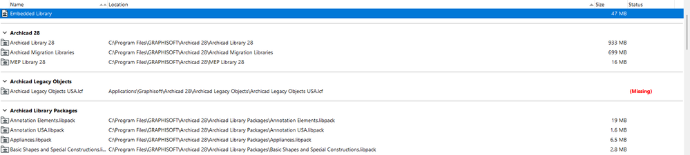

Hi, my project is currently split between two different library systems:
  • Some objects are from ArchiCAD Library 28.lcf
  • Others are from the separate Library Packages (.libpack) that I downloaded recently from Graphisoft’s site

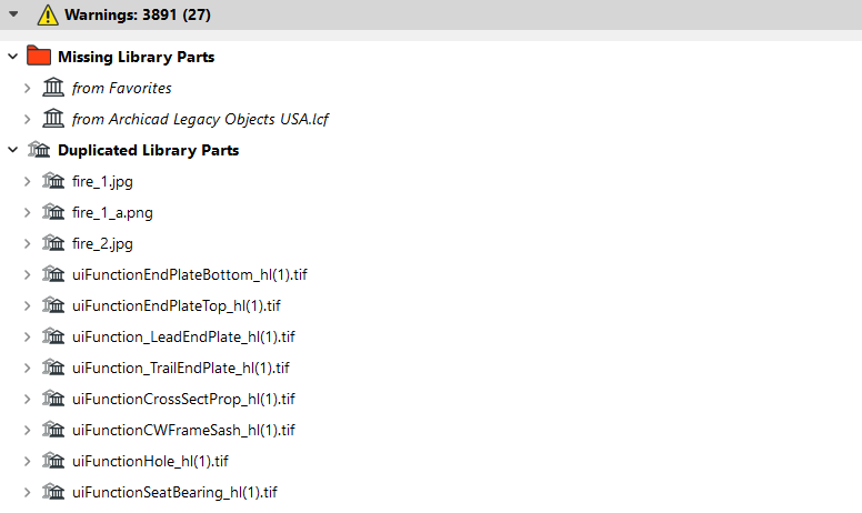

Because both are active,
I’m getting around 2000 duplicate library parts, and some issues.
I’d like to simplify and move to just one library system going forward.
A couple of things I’ve noticed:

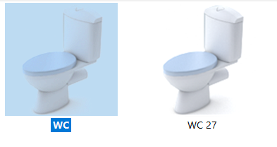

  • A lot of items inside the Archicad 28 library still have “27” in their names, so I’m wondering if that means i should move everything from ArchiCAD Library 28.lcf to separate Library Packages.
  • The .libpack packages seem to be the newer, modular format.
My questions:
how to remove one libarry and move everything to the other?
Would really appreciate insights from anyone who’s gone through this cleanup before 🙏

The Archicad 28 Library that comes with 28 is actually the old 27 monolith library - just labelled as 28.
It is completely separate to the 28 Library Packs (Global Library).
Do not load both at the same time.
There is no migration from 27 to 28 - is is a completely new library.
The duplicates you are seeing are just image files for surface textures and user interface images in object settings.
If you have an old file started in a previous version, just load the Archicad 28 Library an the old migration libraries if you need them.

As there is no migration between 27 & 28, the only way is to manually swap the missing objects from 27 with the equivalent 28 object.
The best way to do that is to remove the 27 monolith library and load the 28 library packs.
You will see all the missing objects, select them and replace with a 28 object.

The easiest way to do that is remove the 27 library and you will be able to see what is missing and then fix them.
