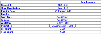

I changed Door GDL code a little bit. Everything work as I expected but orientation text in Schedule got weird. I just want letter L for Left Door and R for Right Door.
What is going on here?

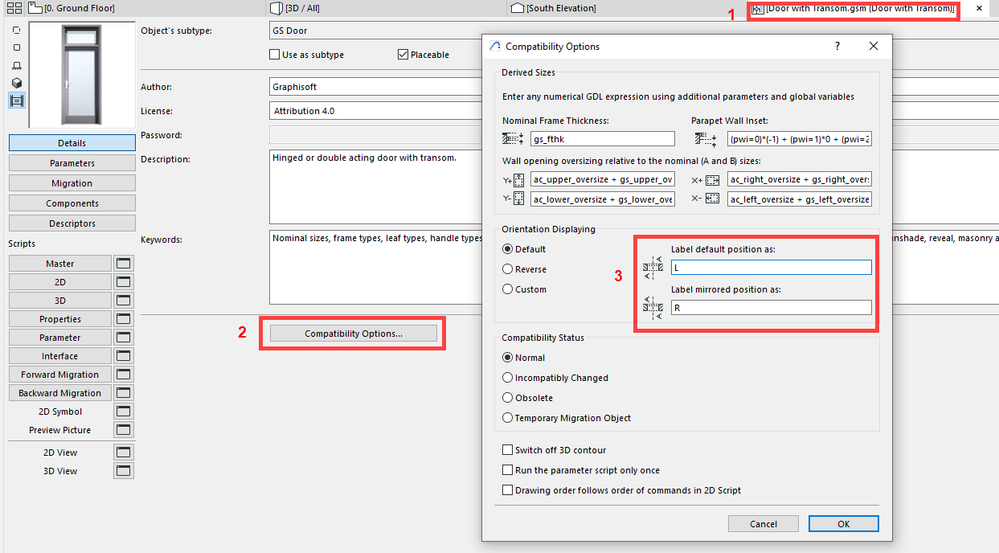

When you opened the Door for editing, did you by any chance change the Left and Right Orientation value fields in the Compatibility Options Dialog?
Can you show me a screenshot that shows the values for your Door?

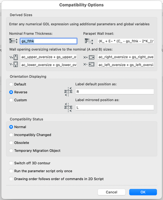

Hey Laszlo, thanks for your answer. I did not change anything in this dialog (difference to your image is because I took USA door for editing). I also tried all combinations witho no changes in schedule.
As I read there is also a script version of determining the Door opening direction. It may be related, but I can't find a macro that edits this output.

My understanding was that those fields (ore or the other) are listed as Orientation in Schedules, so if some other value is listed, I would suspect that it is a bug, so I will report it to GS HQ.
