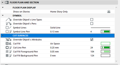

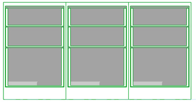

I have kitchen elements next to one another. In real life they are separated, but in the drawing I don't want to be so crazy and split them fo 1mm. The issue is that I can't see separation line, the intersection is happening. Neither is possible to assign a material to different elements (working surface, fronts, ovens, etc...). So I have basically one piece of furniture made of solid material. That is not possible in real life. So, if we want to make drawings for workers, it's impossible using just sections? And developers will keep updating software with useless news, and keeping a bunch of issues behind. At this point, this software is just a frustration machine!
If someone has logical solution for this, let me know. Answers like: creating a bunch of new layers and intersection groups are not accepted! Thanks!Screenshot 2023-01-12 134425.jpg

Hi Milan,
to get separation of materials that touch,
the materials need a different cross section fill,
or Archicad will connect them (think of stacking slabs,  no separation lines)
you will need different building materials(with different sectional fills) applied to the elements you want to separate.
if you change the building material(or section fill) of alternating cabinet carcass then you can have lines created.
i don't know if the cabinetry you are using will allow that to apply individual building materials to the components as you desire.
i assume you want the bench top to connect, but the cabinets to be separate.
i don't know if this helps as i do not know which cabinets you are using.
if you change the overall cut section of each second object to a different fill then you get unit separation.
I changed the fill from "Background" to "Air Space" for the middle cabinet.
The object needs setting for sectional fill for individual components, like the surfaces for individual components, or an upgrade to building materials.
