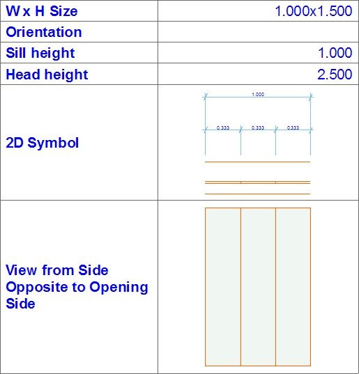

3) About the schedule.
a)Is there a way to easily annotate the drawings from the GDL script ? I'd like to have automatic dimensions for my panels. The attachment is made with the "annotate" tool of the schedule. I know how to check if I am drawing in the Schedule :
IF GLOB_CONTEXT = 6 THEN !Schedule
	iLoD2D = SCALE_50
ENDIF
but I don't know how to draw dimensions objects. I think I can make it work with lines, but quite more complicated.
b) any idea on how to make it work in the elevation view of the window ?
Thank you for your help

I think you will have to do it with lines and Text because there is no Dimension command in GDL. Actually, you could write a Dimension macro that would take all the parameters a usual linear dimension element takes, and call that multiple times, passing parameters in time, to create dimensions in a schedule.
It is what I thought. I'll try it and come back if I have questions.

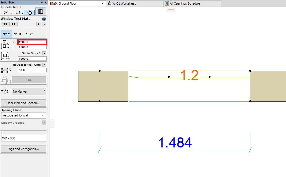

4) Then I'll add my actual concern with the Corner Window that I could be able to answer by checking the source file.
When you add a corner with a corner Window, the size of the wall hole is getting bigger but the size of the window is staying the same. I'd like the opposite way of working, combined with a 2D Hotspot to change the value of the angle.
My actual problem with it is that some Hotspots are automatically drawn by Archicad, that are the size of the wall hole. I am able to draw again the wall hole by myself but I don't know how to get rid of these automatic hotspots.
Thanks for all !

I took a quick look at this, and those hotspots might be built-in and cannot be turned off. I tried a window with zero then one Hotspot2 statement, and the corner hotspots remained. I then tried changing the parameter AC_Hole_Hotspot_Control (part of the Window (Wall) SubType) to zero, and still the hotspots are there. For Objects there is an option for hotspots on the bounding box, I don't see a similar option for Windows. HTH,
David
David Maudlin / Architect
www.davidmaudlin.com
Digital Architecture
David, I came to the same conclusion as you regarding the AC_Hole_Hotspot_Control parameter. No matter how I set it it had no effect on element hotspots.
There is a mention of it in the GDL Library Docs:
http://www.graphisoft.com/ftp/techsupport/documentation/developer_docs/BasicLibraryDoc/16/Window-Mac...
Hi David and laszlonagy,
Thanks for checking. I will explain more why I want these hotspots to disappear, we might find a work around.
I'd like to add a Hotspot controlling the angle of the corner window. I am able to do it quite easily and it works fine. The problem is when this hotspot is matching the basic window hotspot. When i try to use it, it will use the hotspot of the window, and so change the length of my window instead of the angle. Perhaps there is a way to make my hotspot either in foreground or giving it a bigger priority.
I know I could just extend the radius of my angle hotspot but I am trying to avoid having an over-hotspot-ed object. This will be what I will do if we can't find something else.
But then what happens then when you want to adjust the length but not the angle?
You won't really win that one.
Just change the hotspot radius - that is the best/easiest solution I have found.
You never want hotspots overlapping if you can avoid it.
