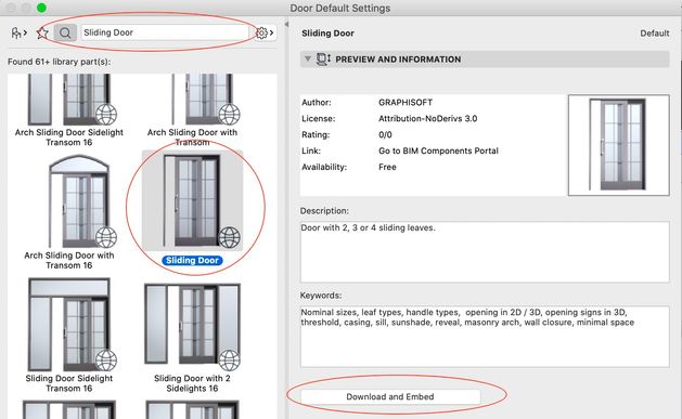

Jesse wrote:
Why don't we have these door options for the USA library?
Hi Jesse,
Sorry I didn't see Brett's post 5 years ago to reply then. We have access to these doors and many more library parts... via an important part of the object settings dialog that will open up a lot of possibilities for you.
The quick answer to Brett's 5 yearr old question is: yes, we can have bypass doors for closets (etc).
Open the Door Settings dialog and type "Sliding Door" in the search field. The internet is searched along with all loaded libraries. You'll see downloadable library parts identified by a stylized globe icon in the lower right. Here, I've selected the "Sliding Door" part from BIM Components. Click "Download and Embed" to download it into the embedded library for the active project.

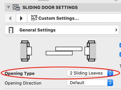

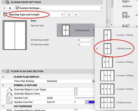

In placing the object, you'll see lots of options for number of leaves and which ones can slide. I picked "2 Sliding Leaves" to give me a bypass door as in the original question in this thread. You'll see that like many parts, there is a drop-down text option, and the same option is shown graphically on another panel.
