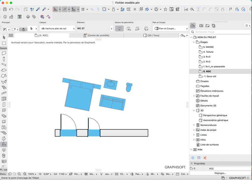

i have some issues with the representation of my entire library (all objects, doors, windows…).
Indeed I'm in the process of creating an archicad model of my own. And I've come up with a new set of pens…
But because of that, my library is blue in plan. As you can see in these screenshots.
What I understand that is happening that the pen that is attributed by the software is linked to the location of it in the palet. And when I created my own it became blue, because I have a blue pen located there. (Correct me if I wrong 🙂 ).

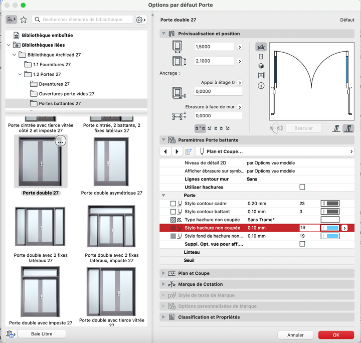

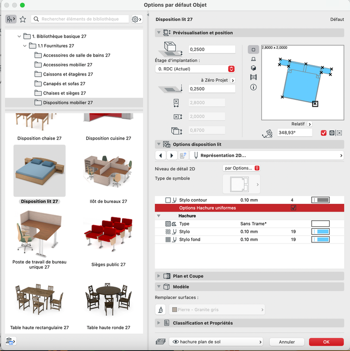

I'm searching for a way to change the pen that is employed for the color of the hatch
And I want too do it so when I save this file as a new archicad model it will stay as I want.

You don't want to be changing default settings of objects.
You can do it but you will have to do it for every object (nearly) in your library and also do it every time you update your library.
What you should do is ensure that certain pens used by objects remain the same - i.e. pens 19 and 91 that are used for the white fill.
The same applies to fills. line types, surfaces and building materials.
You need to find out what your objects use as defaults and keep those in place as is in your template.
Everything else you can change.
