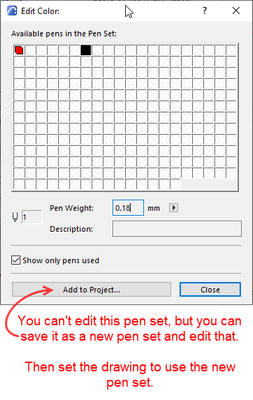

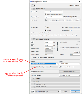

There are 255 pens (number 1 to 255), and each can have their own colour and thickness.
In your image you show pen number 1 as grey and 0.03mm thick.
If your DWG file uses pen 1, that is what you will see if you have it using that 00_SP pen set.
If you are using the Drawing tool to place the DWG, then you can set it you use that 00_SP pen set, while in Archicad itself, you can be using a different pen set.
You can also view the drawings own pen set - it will show just the pens actually used.
You can then save that as a new pen set and edit the colour/thickness of those used pens.
Then set the drawing to use that new pen set.
Or now you have an 00_SP pen set, change the colour/thickness of the used pens in that pen set.

Hi Berry,
Thank you for your reply.
I am a bit new to Archicad, so I am not really sure I understand.
The DWG I import is probably done in another software. Are "pens" simply another terms for "colors"?
What I did is I took the Greyscale pens setting from the option, changed everything to a new thickness and saved with a new name (00_SP).
I have then applied to my external drawing, reloaded the worksheet and it seems to work.
Was it the right thing to do?

Solution
