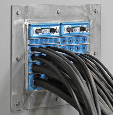

 - for slab penetrations - usually our slabs come in IFC from our structural engineers and they already have their openings and the concrete slabs element are imported as objects (so the hole has a fixed position, I can't move it in archicad). The fire dampers or sealing solutions are represented schematically (i.e. an object/ slab).

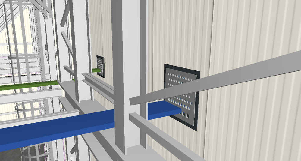

- for wall penetrations -  for a gland plate for example, I have modeled it out of a curtain wall and classified it as such. The cable tray stops before it and it continues afterwards:
This way I can easily adjust and/or schedule them. This has the drawback of needing a opening in the wall. But you can always use a regular window object with a custom panel for those in a similar manner, but you would be having a harder time making non-rectangular shapes if needed.
And this is quite close to how they will actually be built on-site:
Hope this helps.
