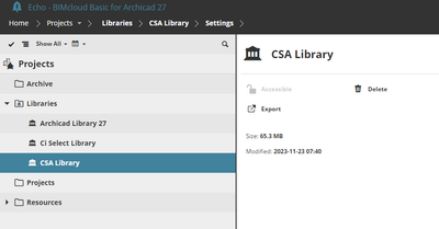

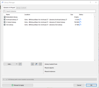

In our Template file all our libraries are located on BIMcloud-Basic.
I have had it setup like this for the last few versions and for the most part works without fail.

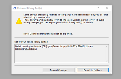

In Archicad 27, whenever I open a file (Solo) I get a notification (see below) "Released Library Part(s)".
The message warns of reservation etc, for an element I edited awhile back.
Despite clicking Discard Changes, the message just pops up again on the next open.
I would go and release the element if I could, but it's a Library not a project file.
Anyone familiar with this, and/or no how to remedy?
