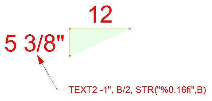

Hi guys.
I've tried to figure this out with the gdl reference guide but to no avail.
I'm trying to get rid of the quotation mark. It's either that or I have to add one to the 12. That's easy but I have no interest in doing that. I've included the text2 statement in the attachment. I started with decimal inches which worked fine but not everyone knows their decimals.I would appreciate a push in the right direction.
Thank you,
Doug
1 REPLY 1
So, here's what I came up with. The extra lines in the Master Script are to deal with Archicad's accuracy.
I added a boolean to switch to decimal just in case. Seems to work pretty well.

2D Script:
PEN PEN_COLOR
!!!!!!!!!!!!!!!!!!!!!!!!!CHANGING THE PITCH!!!!!!!!!!!!!!!!!!!!!!!!!!
unID=1000
hotspot2 12", 0, UNID, B,1+128 : unID=unID+1
hotspot2 12", -1, UNID, B,3 : unID=unID+1
hotspot2 12", B, UNID, B ,2 : unID=unID+1
LINE2 0, 0, 0, B
LINE2 0, B, 12", B
HOTSPOT2 0, 0
HOTSPOT2 0, B
DEFINE STYLE "PITCHTEXT1" "ARIEL", 1.75, 5, 0
DEFINE STYLE "PITCHTEXT2" "ARIEL", 1.75, 6, 0
set style "PITCHTEXT1"
TEXT2 6", B+3", "12"
set style "PITCHTEXT2"
IF DECIMAL THEN
TEXT2 -1", B/2, TOTAL
ELSE
IF FRACT = "" THEN
TEXT2 -1", B/2, STR ("%.0pt", WHOLE_INCHES)
ELSE TEXT2 -1", B/2, STR ("%.0pt", WHOLE_INCHES) + " " + FRACT
ENDIF
